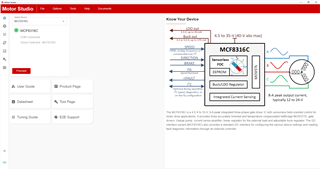

  • It's a MCF8316A but the MotorStudio software detects it as MCF8316C and I can't change it.
  • Hi Thilo,
    That is strange, can you check Motor studio version?
    Also, please try to check Marking on the device.
    Thanks and Best Regards
    Venkatadri S
  • Motorstudio version: 0.1.18
    On the board is printed MCF8316AEVM Rev 2.0 MD038A-001
    and below is a sticker with MCF8316C1VQRGFRQ1

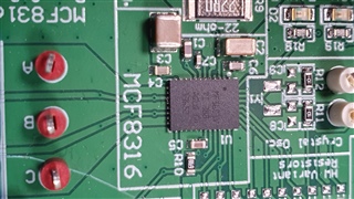

  • Hi Thilo,
    Is it possible to take image (part marking) and share me.
    In case if you have received wrong device we want to verify and take corrective step.
    Venkatadri S
  • Hi Thilo,
    I want some clear image of IC (marking on the IC), can you send me that.
    Venkatadri S
  • This is the best picture I could take:
  • Hi Thilo,
    Thank you, this is MCF8316C device very clear.
    Can you confirm MOTOR STUDIO version? Hope it is latest downloaded from TI.COM.
    Can you show the motor studio main page after device is detected?
    Venkatadri S
  • Yes, the Motorstudio version is 0.1.18.

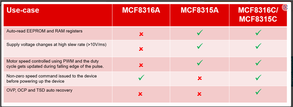

    What is the difference between MCF8316C and MCF8316A?
  • Hi Thilo,
    MCF8316C is improved version of MCF8316A.
    Example, MCF8316A had limited bandwidth for communication while motor is running.
    Please refer to this link for more details (+) [FAQ] Production device information - Motor drivers forum - Motor drivers - TI E2E support forums
    Also, main difference is as shown in the image below.
    Venkatadri S
