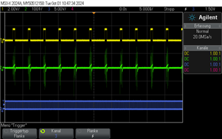

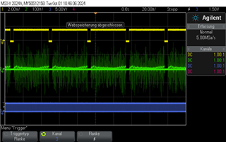

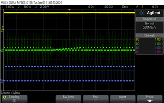

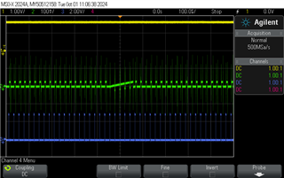

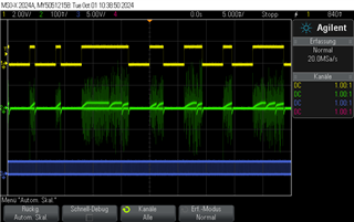

As we set PWM to 30% or higher and then keep it constant and sweep trough frequencies from 10 to 200kHz, the motor speed and its power usage goes constantly up until roughly 100kHz.
At this point, the motor stops, fault LED lights up or the motor drives very poorly while fault LED lights up quite a lot.
As we increase the frequency even more, fault conditions stop, motor speed and power usage increases constantly again to higher speeds than before.
