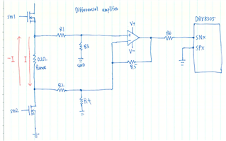

Hello.
I am looking to use the DRV8305 to detect the inline current of a motor.
However, I am aware that the DRV8305 is a low side shunt current sensing and the Current amplifier positive input (SPx) must be grounded.
Therefore, I am considering leaving the Current amplifier positive input (SPx) grounded and introducing the voltage across the inline shunt resistor into the Current amplifier negative input (SNx) through a differential amplifier circuit to detect the current (see attached figure).
Although irregular, is this feasible?
Please let me know.
