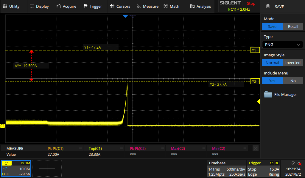

We are utilizing the CSA output analog voltage information from the motor driver (DRV8705S), converting it to digital using the MCU (STM32) ADC, and determining whether the current exceeds the set threshold.
Currently, we have configured a 15A current threshold in the MCU firmware using the internal ADC. When the motor crosses this threshold, we observe an overcurrent trigger; however, during this event, the motor current peaks at 49A before the driver shuts off. Below is the overcurrent waveform of the motor.
Also, currently in firmware we have set the VDS threshold to 0.12V, but when we attempt to lower the VDS threshold to 0.10V, the motor gets stuck.
Is there any other option to reduce this peak current? We want the driver to shut off below 20A, as our motors are rated for 15A.

  • What do you mean by the motor gets stuck? The fault is getting latched? :
    Ans: When overcurrent is triggered in normal operation (with VDS set to 0.12V or 0.16V), the motor speed reduces smoothly and gradually from 90% to 0%, and it stops. However, when VDS is set to 0.10V, the motor stops abruptly when overcurrent is triggered. Please refer to the waveforms below for reference.
    VDS: 0.16V or 0.12V
    VDS: 0.10V or 0.06V
    Can you use a lower VDS threshold for this application?
    Ans: Yes, we can, but as explained above, performance is negatively affected when we reduce the VDS threshold.

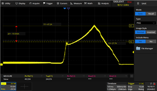

  • Hello Keerthivasan,
    1) Motor in running condition
    Yellow: Fault, Pink: +24V_Mot, Blue: Motor current, Green: GH1(Gate)
    2) Motor in overcurrent condition
    Sonali

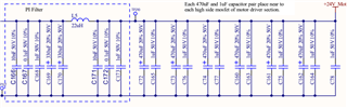

    We have added bulk capacitors per the Evaluation kit schematic. Below is our schematic, we have added each 470uF and 1uF capacitor pair near each high-side MOSFET of the motor driver section. Let us know if we need more bulk capacitors.
    We are working on the waveform you need. We will send you soon.
    Sonali
  • Hi Sonali,
    It looks like there bulk capacitance on the board should be sufficient. What are you using currently to power the board (power supply, battery)? I am just trying to understand why the supply is folding back.
    Keerthi

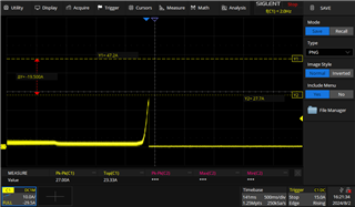

    We use a 24Vdc at 18.8A (HRP-450-24) power supply to power the board.
    Please find the waveforms for VDS: 0.10V or 0.06V where our motor is getting stuck.
    Pink: Fault, Yellow: +24V_Mot, Blue: Motor current, Green: GH1(Gate)
    Sonali

  • Hi Sonali,
    It looks like you are getting a fault in the second waveform you have sent.
    Can you double check once what fault it is?
    Just to clarify the issue is that the motor is getting stuck after this fault? What application is this going in?

  • Hello Keerthi,
    The board already has a 470uF (bulk) and 1uF (bypass) capacitor pair near each high-side MOSFET in the motor driver section. We have now added an additional 100uF bulk capacitor in parallel with the 470uF.
    Please see the waveform below with the added bulk capacitance:
    Pink: SO (CSA output), Yellow: +24V_Mot, Blue: Motor current
    We did not observe any significant difference in voltage drop after adding the extra bulk capacitance.

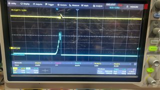

  • Hello Keerthi,
    We have generated the same overcurrent condition on the DRV8705S Eval kit. Below are the observations.
    1) Set-up Image:
    2) VDS: 0.14V, Max current: 48A, No overcurrent fault triggers
    3) VDS: 0.10V, Overcurrent trigger at: 44A
    4) VDS: 0.08V, Overcurrent trigger at: 36.67A
    5) VDS: 0.06V, Overcurrent trigger at: 28.67A

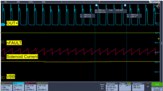

  • Hello Keerthi,
    1) The Below waveform is for the DRV8705S eval kit with SO and nFault signa.
    Vds:0.06v, Yellow: SO, and Green: nFault
    2) We changed the VDS_MODE from Latched Fault to Cycle-by-Cycle on the Eval Kit. See the waveform below. The motor did not stop in this condition.

    1) Sample and hold firmware
    Blue: motor current, Yellow: SP wrt SN,
    2) VDS: 0.06V, ADC Threshold: 15A
    Green: 24V_Mot supply, Blue: Motor current
