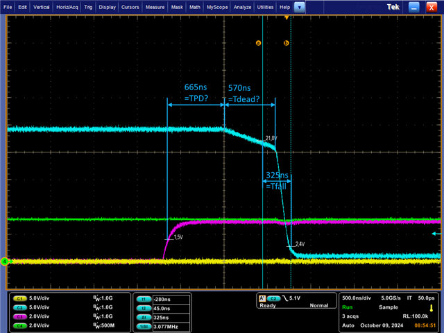

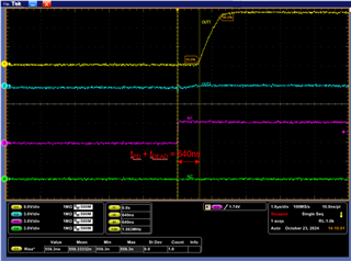

We have found that the trise, tfall, tpd, and tdead times for the DRV8874PWPR are significantly off from their typical values. In the case of tpd, there is more than a factor of 2 between the typical time specified in the datasheet and the time we measured.
Additionally, we noticed that during the falling slope, the voltage initially drops slower, and after approximately 575 ns, it starts to drop faster. I interpreted this time as the output dead time (tdead).
We also observed that the measured times correspond more closely to the automotive variant (DRV8874-Q), but we are sure that the non-automotive version is used.
Please take a look at the oscillograms and help us with the following questions:
    -Are the times measured in the diagram interpreted correctly?
    -What could be the reason for the times being so far off their typical values and for the unusual falling voltage curve?
The test setup is the same as stated in the datasheet: 200 Ohm from each output to GND.
CH1: OUT1
CH2: OUT2
CH3: IN1
CH4: IN2

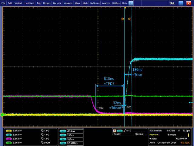

Reverse / Break:
Forward / Break:
CH1: OUT1
CH2: OUT2
CH3: IN1
CH4: IN2
Thanks in advance

    It appears that the control logic is driving the load between Reverse and Brake mode. Could you please try driving the control logic from Forward and Brake mode to see how that affects the timing? To do this, hold IN1 high and PWM on IN2.
    David
  • Hi David,
    I should have added more precise a picture description.
    In the first and second picture, the load is driven between Reverse and Break. In the third and fourth picture, the load is driven between Forward and Break.

    I believe the issue could be from how the measurements are taken. The following image may help with where or how to measure the transition between these times.

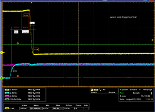

    We are making these measurements, and compare them with the datasheet, to make sure, that our schematic doesn't cause any problems. In this case, there are differences with the datasheet, regarding times and the signal trace.
    Here is a measurement, with the H-Bridge driving a DC motor.
    CH1: OUT1
    CH2: IN 2
    CH3: Pin3 (Sleep)
    In this measurement, the signal trace of CH1 (OUT1) matches the one, that is in the image you sent, but the timings are still far off.

    I'm thinking maybe the capacitors on the output pins could be slowing down the timing during switching. Could you try removing caps on outputs and see if that helps?
    David

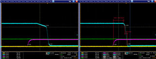

  • Hi David,
    thank you for the reply, you were right, it seems as the output capacitors cause the unusual voltage courve.
    Left: With capacitors. Right: without Capacitors
    CH1: OUT1
    CH2: OUT2
    CH3: IN1
    CH4: IN2
    At 150ns the fall time is now also close to the typical value of 150ns.
    But the other timings still don't match with the datasheet. The time i marked (649ns) is still higher than the sum of Tpd and Tdead.

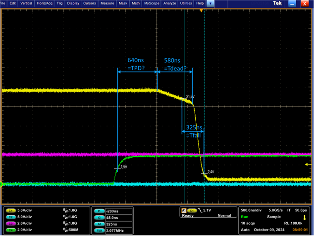

  • Hi Fabian,
    My lab tests confirms the times that you are seeing. I believe the confusion is coming from measuring the dead time. The dead time can be difficult to measure on a scope.
    By looking at the image from my previous post, you can get a more accurate representation of propagation delay by measuring tPD + tdead to the rise time, and subract the typical dead time.
    I was also seeing higher than typical propagation delays (tPD = 640ns - 100ns = 540ns), but the timing is still within the device specs. It looks like the device you are testing is behaving as expected.
    David

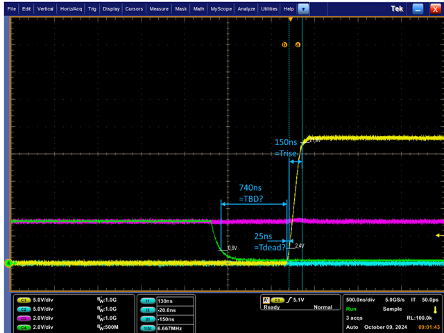

  • Hi David
    To be sure, I repeated all the measurements for tpd+tdead:
    Reverse (output falling)   635ns
    Reverse (output rising)    757ns  (your measurement:640ns)
    Forward (output falling)   570ns
    Forward (output rising)    765ns
    I noticed we compared the wrong times before. (You measured a rising edge, I measured a falling edge).
    When comparing the right times, there are still around 100ns between your and my measurements. Could this be caused by the fact, that you are switching between (coast/reverse) and my measurements are between (break/reverse).
    Please take a look at the those times again and tell me, if those are OK or not.

  • Hi Fabian,
    I was switching from Forward to Coast mode.
    I believe the timings could be different due to the current decay modes used. Although the naming schemes can be a bit misleading, the Coast mode is also referred to as Fast Decay and Brake mode is called Slow Decay. Fast and Slow meaning how quickly the current through the load decays towards zero.
    Please see the following app note on more details on decay modes:
    Current Recirculation and Decay Modes (Rev. A)
    It seems that the timings you are seeing are within expected ranges.
    David
