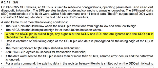

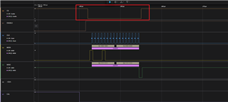

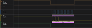

Using a logic analyzer, I can confirm that the SPI clock, CS pin, and transmitted data (MOSI) from the STM32G431KBT6 are correct. The enable pin is also functioning properly. However, the data returned from the DRV8323RS is not as expected.
I ensured that the communication follows the format described in the datasheet under the "Programming" section (Page 52/111). I expected to read back the values I wrote to the registers, but I’m receiving unexpected data that I don't understand.
Even when I ignored the returned data and tried changing the 1PWM_DIR bit in the Control Register to reverse the motor’s direction, there was no effect. It seems the registers are not being written correctly, even though the transmitted bytes appear valid.
I’ve double-checked the hardware connections for any interference and used an oscilloscope to analyze the analog signals, which match the logic analyzer results. I also confirmed that the SPI configurations between the master and slave are consistent, including MSBFIRST, SPI mode, and timing requirements.
Can you help me identify the cause of this issue? What changes or corrections can I make to read back the correct register values and ensure the settings are properly applied?
I will share the Arduino IDE code, logic analyzer screenshots, and hardware setup details for further insights.

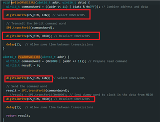

void writeDRV8323RS(uint16_t addr, uint16_t data) {
  uint16_t commandword = ((addr << 11) | (data & 0x7FF)); // Combine address and data
  //SPI.beginTransaction(SPISettings(1000000, MSBFIRST, SPI_MODE0)); // Set SPI speed to 1 MHz
  digitalWrite(CS_PIN, LOW); // Select DRV8323RS
  // Transmit the 16-bit command word
  SPI.transfer16(commandword);
  digitalWrite(CS_PIN, HIGH); // Deselect DRV8323RS
  //SPI.endTransaction();
  delay(1);  // Allow some time between transmissions
uint16_t readDRV8323RS(uint16_t addr) {
  uint16_t commandword = (0x8000 | (addr << 11)); // Prepare read command
  uint16_t result = 0;
  result = SPI.transfer16(commandword);
  delay(1);
  return result;
    //read SPI function
      // Send the command word
        //result = SPI.transfer16(0x0000); // Send dummy word to clock in the data from MISO
      return result;
  • Hi Zied,

    Additionally, in the SPI write-read function, you can verify the signal activity using a logic analyzer. I followed the SPI programming steps outlined in the datasheet to ensure proper synchronization between the SPI pins.
  • Hi Zied,
    I may be missing it but I don't see any line of code where you are controlling SS_PIN (nSCS)? and I also don't see on the logic analyzer where you are controlling SS_PIN (nSCS)
    Yara
  • Hi Yara,
    Sorry for the confusion.
    I meant the CS_PIN: the nSCS/GAIN pin (chip select).
    I've used it in the setup() function to initialize the CS pin, as well as in the read and write functions.
  • Hi Zied,
    Then is it possible to get a trace on the CS_PIN as well?
    In the mean time I'm looking into your read and write functions.
    Yara
  • Hi Yara,
    I hope you are doing well,
    you can find the traces from the LogicAnalyzer
  • Hi Zied,
    Give me about a day to look at these waveforms. Have you changed anything since your last response?
    Yara
  • Hi Yara,
    I hope you're doing well.
    I haven't made any changes.
    Zied Jenhani
