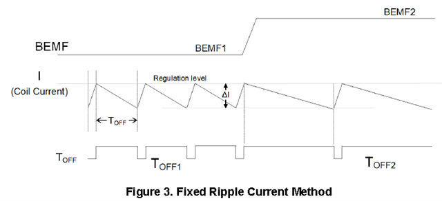

The datasheet says that the phase difference between the BEMF and the motor current is expressed as a torque count, but how can I observe the BEMF waveform?
Also, please tell me how to observe the Toff waveform.

    You can monitor the TRQ_COUNT bit, see 7.3.11.5 Stall Detection in the datasheet for more explanation.
    "The algorithm compares the back-EMF between the rising and falling current quadrants by monitoring PWM off time and generates a value represented by the 8-bit register TRQ_COUNT. The comparison is done in such a way that the TRQ_COUNT value is practically independent of motor current, motor winding resistance, ambient temperature and supply voltage."
    For a "waveform" you can probe the Torque Count pin on the EVM, the MCU on the EVM reads the value of the TRQ_COUNT register and uses a DAC to put this on the test point as an analog voltage I believe.  Check the EVM user guide for more info on that conversion.

    Is it possible to visualize or numerically observe reverse electromotive voltage and Toff(PWM?) in waveforms?
  • Hey Yuki,
    Correct, but it is the MSP430 MCU on the EVM that is doing that after each SPI read.  The DRV8889 does not have a Torque Count output pin itself.
    You can do the same thing with your microcontroller if you externally control and communicate with the DRV8889.  Just read the SPI register and then use a DAC to output the waveform of what you want.
    The firmware for the EVM is available online on the EVM page under software downloads, you could modify that to output something different than torque count.
    Jacob
  • Hello Ando-san,
    You can zoom into the current waveform in the scope and visualize tON and tOFF chopping. It would be a little tricky to visualize BEMF but you may be able to observe it as a sine wave DC level superimposed on the xOUT1 and xOUT2 voltage PWM waveforms. Thank you.
