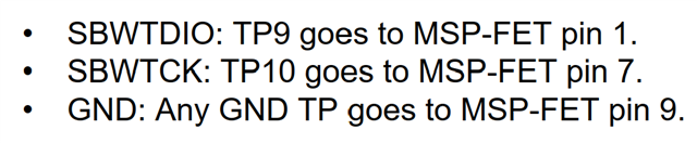

I purchased a new MSP-FET programmer and attached it to the test points on the EVM per ULC1001-DRV2911EVM-User-Guide - slau915.pdf:
Those are the only three signals I connected. The EVM is connected to an external supply at 14V.

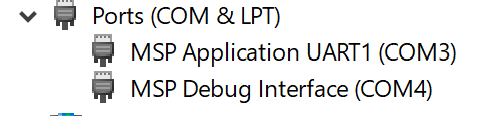

The MSP-FET device shows up in Windows:

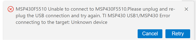

I've tried using CCS and I get this error:

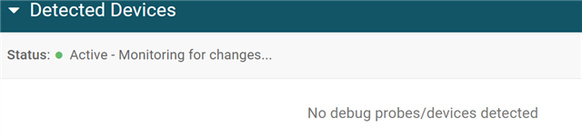

I've tried using Uniflash and I get this error:
When running both CCS and Uniflash, I see the "Mode" light blink RED on the MSP-FET.
Am I missing any other signal connections? Do I need to press any buttons or change any jumper connections on the EVM?
