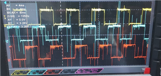

  1.  We have used TI launch pad boards (LAUNCHXL-F28069M) for the model  based development and tested our motor with closed loop configuration. We have used MATLAB model to achieve 6 step commutation.
The  motor is rotating good with control cycle of 500us. When we reduce the control cycle we are observing the control is getting affected because of hall sensor noise. We see that the state is skipping. Can you please let me know if there is anything that we are missing?
Attached the hall  waveform we are getting when the motor is moving.

    The DRV8300EVM comes equipped with filtering circuitry on the hall-state inputs, and I would like to ask if you could measure the hall inputs at the input terminal block to determine if the root cause is the motor itself?
    If so, you may be able to tune the capacitor/resistor values to better suite the motor, or if possible,  test with a different motor to observe the behavior at the same load/control level.

        We are using 1k instead of 10k and rest everything is the same. And we have tested with different motors also. But results are still same. Do you still think we should change the resistor ?
  • Hi Advait,
    Thank you for the clarification.  I think It would be beneficial to chnage the resistors back to 10K to observe the filtering change.
    Have you observed whether this noise occurs at the input terminal before the filtering circuit as well?
