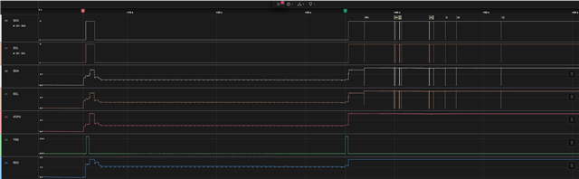

    Dear Hailong, I have some news:
    We found out we have a problem on our power unit. If I plug in the cable (see following picture at red cursor 0) a small voltage ~1.5V will be applied. On system start (power button is pressed / green cursor 1) a valid voltage of 3.3V will be applied.
    If I supply the pcb with an external dc power supply, I can't see haptic driver ICs with a wrong address. It is possible they get crazy with a invalid voltage? But I never thougth they changed the i2c address.
    I'll report back in a few weeks if we have solved the problem with the power supply and the i2c address hopping chips.
