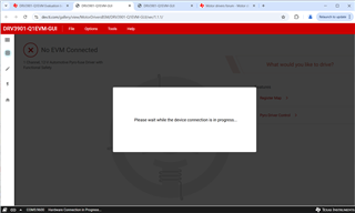

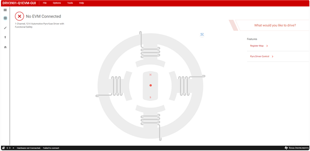

I confirmed the MSP430 drivers are installed for Application UART and Debug Interface UART. It tries to connect, saying "Hardware connection in progress" with 9600baud on the application UART, then it says faild to connect.

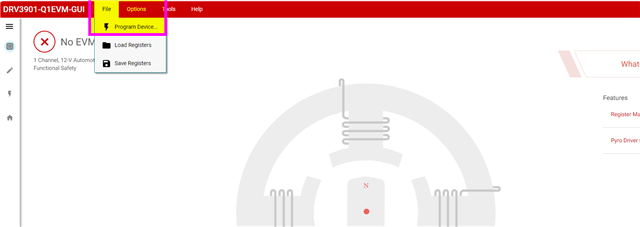

I don't have a "File" tab on the browser GUI I invoked from the TI resources page for the device.
Hi Jon,
Once it fails to connect, it should give you that option:
Keerthi
Got the File tab and loaded the firmware successfully. Still not able to connect. I tried with the browser GUI as well as the standalone app. Might be a board issue at this point.

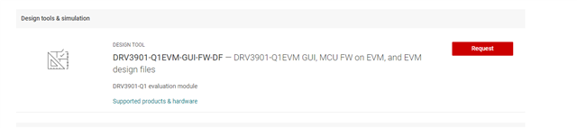

Hi Jon,
You can request the board files and schematic through this link on the DRV3901 page:
DRV3901-Q1 data sheet, product information and support | TI.com
