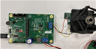

  I used the MCF8316AEVM for drivering the motor by follow the step of the user's guide,i have some problems:My hardware setup is as follows:
The load file is as below:

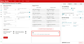

when i load the config and click the run MPET,i pull the slider to drive the motor successful,then i click the MPET reults to shadow registers the logs note the action is been going on,how do i make sure the MPET reults is writed to the registers sucessfully?
 Another question,i want to drive the motor in closed loop,What should I do next?

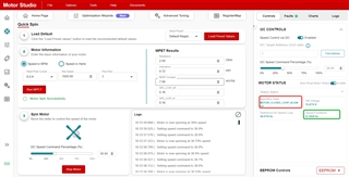

    2、I used the MCF8316A GUI yesterday but it can't drive the motor,today I'm using MOTOR STUDIO GUI(Rev0.1.18) instead,i downloaded the file you provided from the forum when I loaded it,the motor can work well.
    3、The motor current is 0.3A and the rating speed is 1700RPM
    I just checked  the MPET reults are writed into these registers,pls look at the blew picture,these MPET values are consistent with the results measured by the GUI
    When the motor works i find it was in closed loop mode,what I don't understand is that I set the current duty cycle to calculate the current speed of the motor at 9.7Hz by the encoder, but the speed feedback suggested by the software is 67.9Hz, should I divide it by pp to determine the actual speed?(my motor PP is 7)
    After the motor is working for about 5 minutes, it suddenly stops and the GUI has no fault. When I click "stop motor" on GUI and reset the duty cycle, the motor will not work again, and LED6 is blinking at this time. i want to konw what causes this and how to solve it?

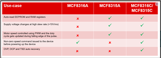

    I also want to recomend to switch to MCF8316C instead of MCF8316A due to some limitations.
    MCF8316C is improved version of MCF8316A.
    Example, MCF8316A had limited bandwidth for communication while motor is running.
    Please refer to this link for more details (+) [FAQ] Production device information - Motor drivers forum - Motor drivers - TI E2E support forums
    Also top level difference
    Thanks and Best Regards
    Venkatadri S

  • Hi Suy,
    I wanted to share the errata information with you about MCF8316A.
    The difference between MCF8316A and MCF8316C is available in the earlier conversations.
    Do you have anymore questions?
    Venkatadri S
