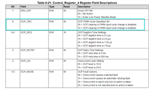

When I was configuring register 4, I saw OCP_CBC and there was no introduction about it in the datasheet.
Can you clarify the functionality of this configuration?
I understand that changing the PWM output can clear OCP fault ,right ?Which PWM input does this refer to?
