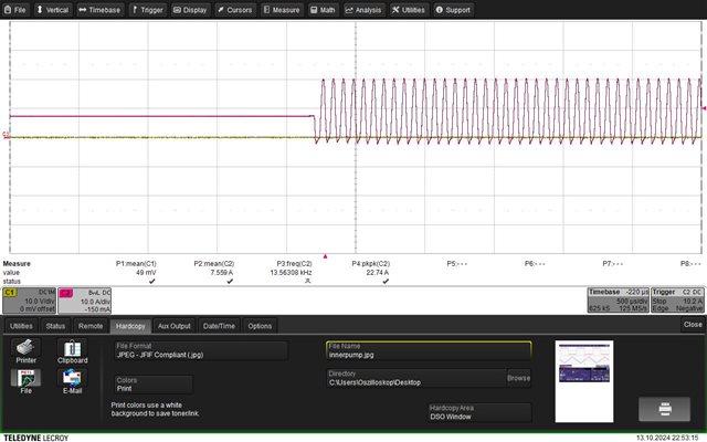

I'm trying to use the ITRIP regulation function on the device however after reaching the trip current, the device oscillates for a brief time and then shuts off due to over temperature. As you can see from the image the peak current is 22A however the ITRIP current is 7.5A, the device senses this value but reacts to it very slowly. What might be the issue causing this regulation current to reach peak 22A values? How can I fix it?

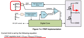

    1) DRV8143-Q1 has current regulation function if it has low side load configuration. Current sense exists on high side FET only. If you load is high side load, ITRIP regulation never happens.
    2) Itrip level is determined by external resister and VTRIP selection. For example, if external register is very small, you may not see ITRIP regulation.

  • Thank you for your answer.
    The waveform is from an electronic load as a low-side load measured from the DRV8143's output. The ITRIP regulation is happening however the current seems to go well above the ITRIP value which causes the device to go into fault mode due to overheating. Also mind that I achieve this behaviour after I reach the ITRIP current value 7.5A at the output, so the regulation starts as expected.
  • HI Baris,
    Thak you for your update. ITRIP operation is designed for motor/inductive load. Not for resistive load. And electronic load may have some unique behaivior.
    I suggest to have motor load or inductor(e.g 10mH).
    After motor or inductive load, please review followings calculation formula.

  • Thank you Shinya. It seems like my problem results from the electronic load not being inductive. The peak current decreased when I supplied the output with an inductive load.
