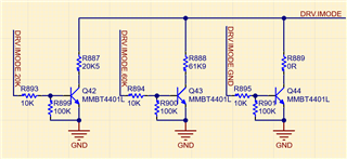

In our design, we are using DRV8876-Q1.
For the IMODE selection,
IMODE selection resistors are attached.
We are using 20.5k instead of 20k and we shall use 52.3k+10k instead of 62k resistor.
Is it okay for the application?
Additionally for the software selectable IMODE these resistors connected via npn BJTs,
Is it applicable? Does BJT voltage drop cause any issues for the application?
