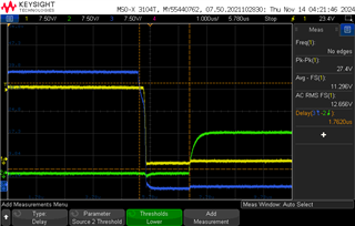

DRV8328: DRV8328A Dead Time Higher Than Expected
Part Number: DRV8328
Hello, I am using the DRV8328A with the DT resistor set to 100k. Based on this, my dead time should be 550ns minimum. I have verified the resistor measures 100k and the firmware is set to a dead time of 416ns. The actually measured dead time is 1762ns.
