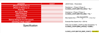

    Let us take following approach
    1. Run MPET to measure KE
    2. Test in current loop

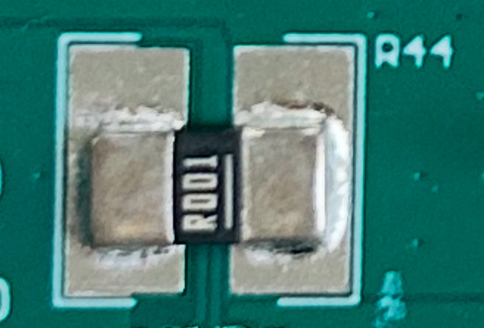

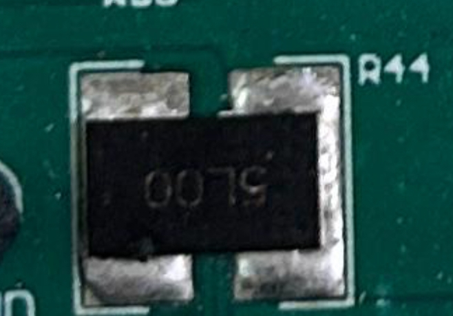

    Can you also share image of the EVM you are using? I want to confirm about the RSENSE resistor?
    I will create reference JSON and share you by early next week.

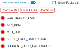

  • Hello Venkatadri,
            I had check the following things
    1. VM magnitude - Can be readable. And it is showing as 93.xxxx and sometimes 99.xxxx.
    2. Saturation - Enabled already
    2. Single Shunt Blanking Time - Existing is 0.75 us and i had changed it to 0.25us.
    I had tested the performance of the motor in the Magtrol HD 710 Dynamo Meter. And finds the following issues while using the attached Register settings.
    Please check the following and share your feedback as well as the solution/ modification required in the existing register settings.
    1. The motor is running and took around 0.31 Nm of torque and current of up to 5.74A.
    2. After that stage, only the current will consumes up to 7.25 A and the torque won't gets high. But the speed remains same for the 0.31 Nm.
    3. As we had discussed with the technical team with Magtrol, they said that the controller will push the current to maintain the speed and not apply the torque.

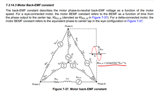

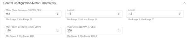

    4. Also, i had a doubt that whether this controller runs based on the Id and Iq as a references. Also the speed is not controllable using analog potentiometer even when the CTRL_MODE is set to Speed Control.
    5. BEMF Constant is now set to 105 mV/Hz (It was given by you). But actually i had given the value as 59 mVs/rad. How do you calculate this.
    6. If there is any other way to edit the backend coding to make the software more comfortable for my application.
    7. Currently i had a controller with a shunt resistance of 1. m Ohm. Is this can plays a major role in this case.
    8. Also provide the calculation formula for the Phase Inductance calculation from Ld and Lq.
    Please provide all the documents related to the TI Motor Studio. It is much helpful for me to understand how the software and the hardware is working.
    If it is possible kindly schedule a meeting to discuss clearly about the application and requirement.

  • Hi Rajapandi,
    I forgot to ask about RSHUNT value. What is the RSHUNT and can you attach image of the board here?
    Thanks and Best Regards
    Venkatadri S
  • Hi Rajapandi,
    I looked at earlier thread  where you have mentioned R Shunt 1 mohm.
    I want to verify the part number of that shunt. In the very initial EVM we had Rshunt which had offset issues.
    We later replaced the BOM , I want to verify the RSHUNT used on your EVM.
    Can you post the image of the EVM here?
    Venkatadri S
  • Hello Venkatadri,
     RSHUNT value is 5 mohm 10 watts. I had replaced the 1 m ohm resistor with this 5 mohm resistor.
    RAJAPANDI S
  • Hi Rajapandi,
    The JSON file required many changes. I reduced close loop acceleration, deceleration, IPD current threshold.
    Slightly increased open loop current limit.
    I changed CSA gain to set Base current to 30A, earlier it was 7.5A for 10mohm shunt. I assume the RSHUNT is 10mohm now.
    This JSON is for 10mohm

    I had attached the RSHUNT resistor image FYR. Meanwhile please increase the max current limit to 15 A at the same time base current would be 30A.
    In this image the RSHUNT resistance is 5 m Ohm. Please consider this and share your thoughts if any modification needed in the RSHUNT. Like make, wattage and tolerance.
    Thanks and Regards,
    RAJAPANDI S
    I had attached the old RSHUNT resistor image for your reference. We had replaced the RSHUNT value to 5 m Ohm 10Watts. The replaced one image is already shsred with you.
    Thanks and Regards,
    RAJAPANDI S

  • Hello Venkatadri,
          I had run the JSON code and got the following startup errors. I had attached the screenshot FYR,
    Thanks and Regards,
    RAJAPANDI S
  • Hi Rajapandi,
    Is this on 5mohm board?
    Venkatadri S
  • Hello Venkatadri,
          Yes i had loaded the code into that 5 mOhm board and got the following error.
    Thanks and Regards,
    RAJAPANDI S
  • Hi Rajapandi,
    I see the tuning file used Resistance of 1.5, in your initial thread resistance is line to line.
    MCx need line to line /2 and same for inductance.
    Please refer to the initial discussion where I have mentioned how to use parameters

  • Hello Venkatadri,
        As per your answer i had calculated the R and L. The values are 0.8 Ohm and 2.175 mH respectively.
    Ke = [(13.6/2)*0.034]/√3 = 119.34 mV/Hz.
    Here we had measured the BEMF constant at 1000 RPM.
    Thanks and Regards,
    Rajapandi S
  • Hi Rajapandi,
    The new value is correct.
    Did you use this and verified?
    Venkatadri S
  • Hello Venkatadri,
           Here there is one doubt that in Ti studio there is an option to enter only the Ld and Lq. I had a value of Ld and Lq measured for line to line. Whether i need to use half of the line to line value or not.
    Also what will be the Maximum Speed. Is this Maximum Speed refers the frequency or the RPM?
    Thanks and Regards,
    Rajapandi S
  • Hi Rajapandi,
    This is electrical HZ, if you know number of poles then it is 120*F / P is the rpm and F is the electrical Hz.
    Venkatadri S
  • Hello Venkatadri,
          I understood that. There is an one more thing that i need to increase the maximum current limit to 15 A (should be delivered to the motor). The existing JSON code can able to deliver maximum of 5 A only. How do i do it?.
         I had attached the json code FYR.
    Thanks and Regards,
    Rajapandi S

  • Hi Rajapandi,
    Please verify BASE CURRENT programmed from GD_CONFIG1 (CSA_GAIN) and GD_CONFIG2.
    In FAULT_CONFIG1[ILIMIT] is %of BASE_CURRENT.
    If these two are above 15A, then you need to apply load .
    Sine you are seeing CURRENT LOOP SATURATION which means motor is already at max speed and further increasing will not be possible.
    Hence you need to apply load and verify.
    Venkatadri S
