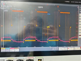

We use 8889A to drive the motor, configured for 1/4 micro step, Smart tune Ripple Control mode, providing 480 pulses per second on the STEP pin, and the motor noise is very loud. We also tried other PPS and micro step parameters, but the motor noise did not significantly decrease. The motor supplier told us that the motor drive current cannot be reduced, otherwise the motor cannot be driven. How can we reduce motor noise and make the motor drive waveform approach a sine wave. Q24BYJ48-3361w.pdf

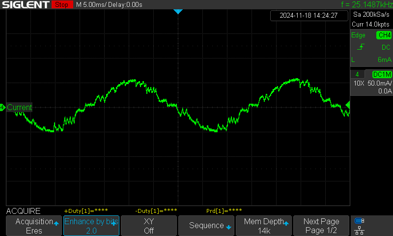

    See below current waveforms using our EVM and an example motor which is similar specs but a bit higher DCR 220 Ω, VM = 12 V, IFS = 80 mA, 1/4 step mode, 480 PPS on the step pin.

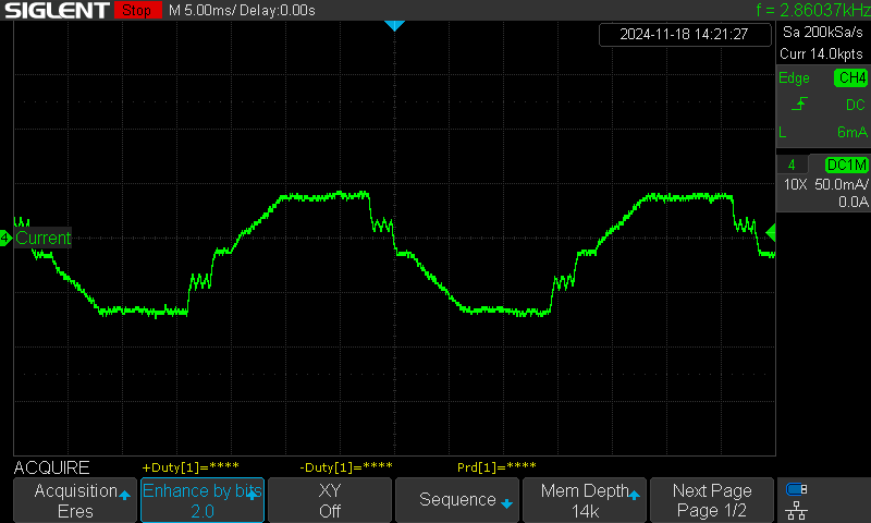

    IFS = 50 mA, rest of the settings identical to the above.

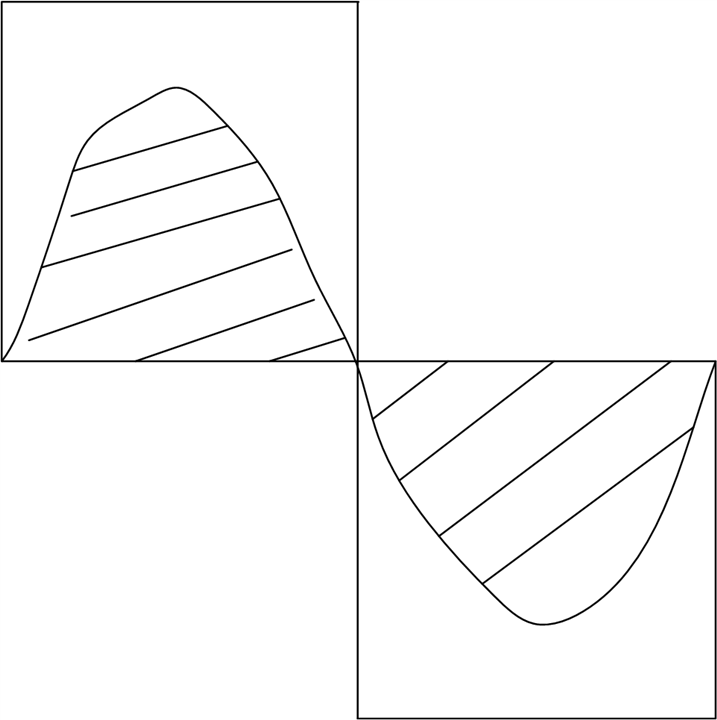

    According to the motor datasheet you shared there is a specification for output torque at a certain speed. Typically this specification is for full-step mode and direct drive meaning the steady state current is V/R = 9/150 = 60 mA IFS. In full-step mode the current waveform would be close to a square wave. The output torque is proportional to the area under the current waveform, both positive and negative must be added with modulus. Using this approach find the area of the square wave with 60 mA amplitude and the STEP period width as well as with the sine wave area under the curve - see the second snippet. The ratio will give you the estimated output torque of the stepper. With sine wave current the motor will run quieter and cooler but the torque will be the maximum with the full-step square wave.
