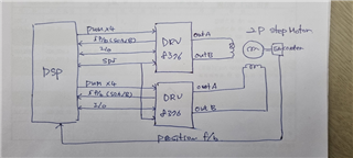

I am trying to FOC control a 2-phase STEP MOTOR.
However, there is no suitable component in the driver part, so I am trying to control it using DRV8376 as shown below.
There seems to be no problem, but I am wondering if it is okay to use ILMIT processing and only 2 out of 3 phases like this.
Thank you.

    I don't think I see an issue with using only 2 of the 3 phases, how are you handling in the input and output pins of the unused phase?
    Can you clarify what you mean by ILIMIT processing?
    Yara

    1. GND the unused C-phase input and open the OUTC output.
    2. I would like to know if the DRV8376 works without the C-phase current when using the "Cycle-by-Cycle Current Limit" of the manual "7.3.12".
    3. And in the manual, it seems that the DRV8376 can use both the "Cycle-by-Cycle Current Limit" function and the "Current Sense Amplifiers" function. Is that right?

    I think there may be an issue with cycle by cycle ILIMT if you are only using 2 of the 3 phases but I'll have to check with my team to make sure.
    In regards to current sense amplifiers or CSA, I believe it should work with cycle by cycle ILIMT, they are two different functions.
    I believe the CSA only measures when the low side FET is on since they are low side current sense amplifiers.

    I have an update from our system engineer
    1. Will cycle-by-cycle current limiting work if only 2 phases of the 3 are used?
    ILIMIT will now check (current of phase A + current of phase B)/3, as current of phase C is zero. You should use the same equation in datasheet and need to take care of the division by 3. You might have needed division by two. This scaling needs to be taken care.
    2. Can both cycle-by-cycle current limiting and CSA features be used?
    Yes
