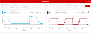

Hi
I am experiencing a start-up issue with the MCF8316C. I am using the Maxon 449464 motor.
The application uses PWM (5kHz) to control speed, and the test I am running consist of 3 seconds run (stepped 0% to 16% duty cycle) followed by 2 seconds off (stepped from 15% to 0% duty cycle) repeated indefinitely.
Randomly from time to time, the driver doesn't start the motor up, although the algorithm has ramped up to closed loop control:

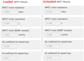

MPET results for loaded and unloaded motor shown below, currently using unloaded values to run testing. Should the loaded values be used instead?
Configuration file also attached.

  • Hi KAIYU,
    I looked at motor data sheet (Maxon 449464), as per this max speed of motor is 15000 rpm and 7 pole pair, this will be 1750 electrical Hz.
    Can you confirm about the JSON you shared is appropriate for the motor?
    You have selected startup as slow 1st cycle, startup speed as 2% which is 14Hz as 1st cycle hope motor inertia can support it.
    You have also set very high closed loop acceleration 2000Hz/s, if Speed KP, KI gain is not adequate we may not be able to achieve this high acceleration.
    Regarding startup you can try IPD if you need fast startup or ALIGN/DOUBLE Align as beginning until you get control about spinning the motor.

  • Hi KAIYU,
    About MPET question: No need to configure max speed, we need to consider some aspects like when MPET is measuring KE, it needs to be sufficient speed at which BEMF is properly measurable.  BEMF generated by the motor also indicates motor speed range capability for the applied voltage.
    About thermal
    1. PWM modulation: You have tried Discontinuous SVM
    2. Reduce switching frequency to 15KHz
    Can you use multimeter for  R, L measurement to re check if the values are proper as per data sheet?
    The data sheet says R is 0.5 ohm phase to phase but the JSON file is 0.375 ohm, the R, L error can impact sensor less efficiency.
    Are you testing on EVM? What is the temperature which you are seeing and what phase current?
