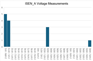

Edit: Here are two histograms for the above tests.
The first shows the vanilla firmware

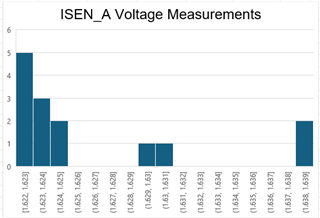

And this second one shows a change to the test FW, where the calibration of the current sense amplifier has been delayed by ~40ms power boot up to reduce effects of the device boot and power supplies coming up.

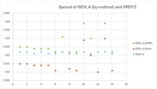

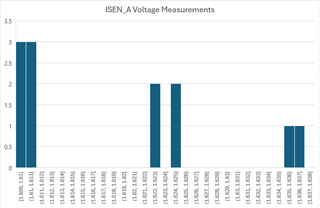

After this post I performed further measurements. The test FW disables the gate drivers, and there is no current through the shunt resistors. So the measured zero-current output of the amplifier should in theory be VREF/2. To confirm that the measurement method was not producing the discrete values, I performed the output measurement on both a digital multimeter, and a Picoscope on 14-bit resolution. There is a small offset between these two measurement methods, but this confirms that the measurement device is not the source. The below histogram shows the spread of amplifier outputs (ISEN_A) between power cycles. The plot below shows that VREF (the 3v3A power rail) is not the source, as it remains fairly stable even when output is doing this "latching" between different values on the output.

    The Input offset error when SP and SN are shorted can be between -3 to 3 mV. Which with a gain of 20V/V can result in an output fluctuation of 60mV. We can see that the values you have measured are well within the specs of the device. There will be some variation which is why we have put this spec in the DS.
    When the device runs the calibration and the input is shorted we expect Vref/2 but with some real world variance so, we trim the SOx. This could explain the three distinct values.
    If you want even more accuracy then you can account for the 'real' vref value in your software since vref rail might have some variation.

  • Hi Akshay,
    These measurements were made with code that did perform the amplifier calibration again about ~40ms after the device boot to give the power supplies time to settle. The reason I think this is not related to VREF, is in the additional graphs I added to the post. VREF is essentially constant, but the mid-point of the amplifier when grounded in jumping around (the last graph I posted). We do know that our VREF does actually have some variation, particularly with temperature. But as I said, there does not appear to be a correlation between VREF and the calibration.

    The three distinct values could be a result of the trimming process during calibration from our digital design. So we would not be able to change this unfortunately.
