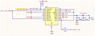

This is my design as shown below. The aim is to have 16 independent latching solenoid drivers, but for some reason, it was not able to output a high voltage of 12V. The maximum voltage being output was 0.7V.
After some investigation, I noticed that ISEN12 and ISEN34 were left floating. As I did not want to limit the current, these were left floating. However, I believe the correct approach would be to connect these to GND. This will be addressed in the next version of the PCB, where they will be connected to GND.
The question I have is regarding the TRQ pin. It seems this also affects the output current. How should this pin be set?
Thank you.

    Yes, you are correct to connect ISEN12 and ISEN34 to GND in order to disable current regulation. The TRQ pin, is used as a scalar input to scale the current regulation threshold. It shouldn't matter whether you connect the TRQ pin high or low as it is just a scalar, but good practice would be to connect it to GND.

  • Thanks,  So the torque, is better to keep it floating or GND? As I am not limiting my current
    Thank's I will read the application notes
    It's generally a good practice to tie the TRQ pin to GND. This ensures a stable operation and minimizes the risk of noise affecting the pin. While leaving it floating won't cause immediate issues, connecting it to GND is a safer and cleaner approach.
    David
  • Thank you, I will correct this. I will connect the ISEN and TRQ pins to GND.

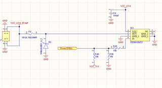

    In the past, I have used a circuit similar to the one shown below, which includes a protection diode. Am I correct in understanding that this driver already incorporates a protection diode?

    Correct, you don't need to include a protection diode. The device has integrated freewheeling protection diodes to recirculate the load current during PWM off time.

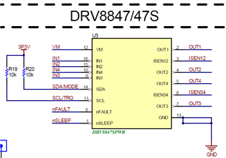

    This is how I intend to use it for my other application. All the ENB and signal lines are connected to the same net.
  • Hi ,
    After reviewing the schematic posted above, I see some possible issues that could prevent from connecting the device in parallel mode.
    1. The absolute max ratings for the digital pin voltage (IN1, IN2, IN3, IN4, TRQ, nSLEEP, nFAULT, SCL, SDA) should not exceed 5.75V, its recommended to not exceed 5V for these pins.
    2. In order to use the parallel bridge interface, both the MODE and IN3 pins need to be connected to an external 3.3V or 5V supply. Then IN1 and IN2 pins can be used to control the driver.
    From the schematic, MODE is a left floating and inputs are exceeded input voltage range.
    Please see the datasheet for more information on the parallel bridge interface

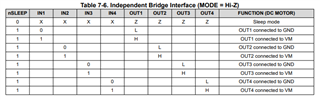

    I used the independent mode to drive them all at once. This way, all four output pins can be output compared to only two pins in parallel mode. Is this not possible for this application?
    All the GPIO are 3.3V. The net is called "Ext_12V_Enb", but it is 3.3V
  • Hi Dharmesh,
    No, the device is not designed to be connected in parallel while operating with independent control. There is a possibility of shoot-through if the timing doesn't match up.

    Please read the section 7.3.3.4 of the datasheet for necessary connections for the independent bridge interface.

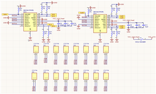

    We aim to use the same IC in multiple places on our PCB, this way we have one driver IC-type device is going to be used in two different ways on the PCB.
    One is the parallel method as shown in my previous post. and the other is independent as shown in the schematic below: I believe the independent schematic is as per the datasheet.
  • Hi Dharmesh,
    The independent bridge interface schematic looks good.
    Please follow the parallel bridge operation connections in the datasheet for appropriate connections of inputs and outputs. The MODE and IN3 pins need to be connected to an external voltage source, while IN4 is in a don't care state. Inputs IN1 and IN2 are then used to control the outputs. This means the output connections should be as follows in the figure below:

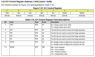

    I might be wrong but in the datasheet it shows you can set input pins via the reg.
    Instead of purchasing a eva kit it would be more better to get the PCB made, but want to make i2c will work instead of using gpio pins
  • Hi Dharmesh,
    My mistake. Yes, you are correct. It looks like you can use the IC1 Control Register to control inputs.
