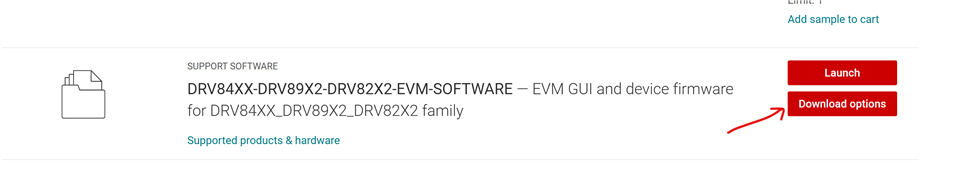

    The EVM CCS project and source code files can be downloaded from the EVM webpage https://www.ti.com/tool/DRV8462EVM, using this link https://dr-download.ti.com/software-development/support-software/MD-abhVTZhobH/1.0.2/DRV84XX-DRV89X2-DRV82X2-EVM-SOFTWARE.zip. The zip file contains a separate folder for the EVM firmware files.
