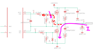

We am using the DRV8300D for one of our projects.
This project is working and already in production but we are have issues somethings with the motors.
There are zener diodes between the SHx and GHx and between the ground to the GLx.
The ones between the ground to the GLx.are non issue but it occurred to me that ones between the SHx and GHx can become forwarded biasd and conduct from the SHx (from the motor phase essentially) to the GHx when GLx is on anf GHx is off.
Is that a problem?
Should I remove it or place a TVS instead? Is it even required to protect the MOSFETs gates? I remember seeing it on the evm board.
The motors are powered by a 16V supply but the Back EMF can be higher.
The DRV8300D is powered by a regulated 12V supply.
Attached is the section of the circuit in question.
