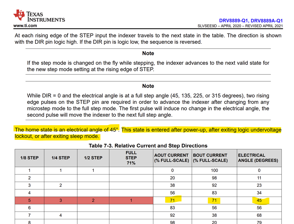

    The reason I came to this idea was that I used software for EVM products provided by TI company, not PCBs manufactured at first.
    When I pressed the DRIVER OUTPUT button, I thought that the motor does not rotate, but as the current goes up, it supplies power to the magnet in the motor so that the rotor is not in the middle of the magnet, but in the right place. Until I pressed the START STEP button. I thought the DRIVER OUTPUT button was the function to turn on the DRVOFF, or H bridge, of the IC. Is that right?

    This is totally fine. A lot of mechanical stability related settling comes from the mechanical inertia of a system. So if this works for your system behavior this is good practice. When the device wakes up and enabled for the first time before issuing step pulses the indexer will start at home position of 45° electrical angle with both coils A and B at 71 % of the target current. See below table from the datasheet. Depending on the last position of the stepper motor rotor the motor may move a little to align the poles for this excitation. This is normal behavior of a stepper motor.

    When you're stopping the motor from running by stopping the step pulses use the following sequence. First stop issuing the STEP pulses. The indexer will stop and the coils will have current defined by the indexer position. Note, it may not be the home position. At this point the H-bridge would be still active and the stepper motor will have some hold torque. This will dampen vibrations. After 30 ms (or whatever delay works best for your system) the H-bridge can be disabled to avoid motor heating.
    For changing direction you can follow similar sequence. Stop step pulses -> wait for 30 ms (don't need to disable H-bridge if you are changing the direction and running immediately) -> change direction (because index position will not change without step pulses the motor will not have any unwanted movement) -> issue step pulses to start the motor in the new direction or disable H-bridge if motor does not need to run at this point.
    If you enter sleep mode after disabling the H-bridge the indexer will always reset to home position and start in home position when you awake the device. If you do not enter sleep mode after disabling the H-bridge the indexer will remain in the last stopped position. The benefit of this would be the stepper motor will not have a rotor re-alignment when H-bridge is enabled again.
