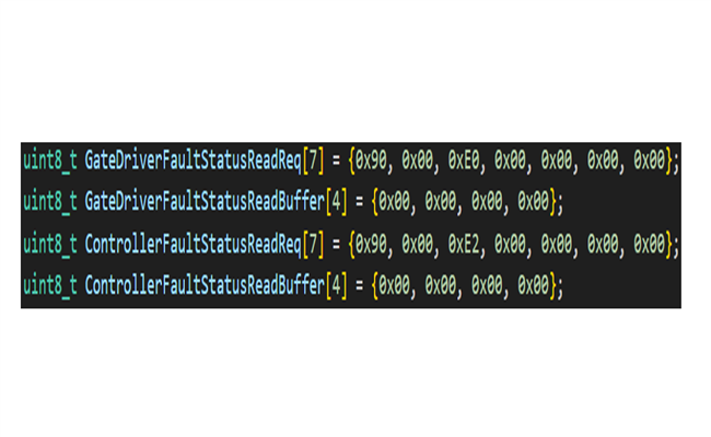

Hello, I am currently developing with the MCF8329AQ1 and encountering an issue during I2C communication. Let me explain the situation step by step:
  1. To read the GATE_DRIVER_FAULT_STATUS register (0xE0), I created and sent the GateDriverFaultStatusReadReq buffer as shown in the attached image.
    (Task completes once)
  2. The response was received in the GateDriverFaultStatusReadBuffer.
  3. To read the CONTROLLER_FAULT_STATUS register (0xE2), I created and sent the ControllerFaultStatusReadReq buffer as shown in the attached image.
  4. The response was received in the ControllerFaultStatusReadBuffer.
  5. For the ALGO_DEBUG1 register (0xEC), I parsed and wrote the target speed value and sent it.
I implemented this process to run continuously in a 2ms task, but the I2C communication with the driver malfunctions intermittently. When enabling only one Read or Write operation at a time, adding a delay of approximately 1.1ms between communications allows for successful operation. However, when testing with multiple registers enabled simultaneously, the timing seems to vary.

    Thanks for your question, we recommend around 15ms of delay between the I2C frames for a reliable communication.

    Only for the device, a 15ms would be needed to take another command. For e.g:
    Send (request) --> wait 15ms ---> Send (another request).
    And while this is happening, you can store the received data in a FIFO?
    Let me know if I understood your implementation correctly.
    I will get back to you with respect to the 64-bit option.

    By "actually receiving the response", you mean receiving the full data bytes into your buffer right? If yes, this time should not be more than 2ms according to my calculations. But TI does not have a recommendation here, since it depends on the clock frequency at which you are operating.

    I set the interval between Request and Receive to approximately 2–5 ms and the interval between consecutive Requests to 15 ms, and the communication is now working well.
