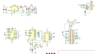

DRV8847: How to replace KA3100D with DRV8847 ? i tried with 2 pin interface .but when i sent Inp1 & Inp2 both o or 1 , the respective outputs are improper.
Part Number: DRV8847

  • Dear David,
    In our hardware we are sending IN1,IN2,nSLEEP signals  to DRV8847 serially using IC 74HC595 . Hence these signal bits either can be 0 or 1 . For moving thermal printer motor in forward direction , we  are setting IN1 bit as 1, nSLEEP bit as 1 and IN3 pin is grounded. Please let us know how to make IN2 pin float as it's connected to DRV8847 serially.
    Or whether we need to connect IN2 direct from Microcontroller to DRV8847?
    Thank you.
    Kalpana

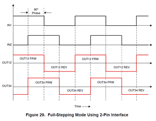

  • Hi Kalpana,
    Is you load a stepper motor or brushed-DC motor?
    If the load is a stepper motor, using the 2-pin interface, IN1 and IN2 will need to be set 90 degrees out of phase with each other to achieve a full-step sequence.
    David
