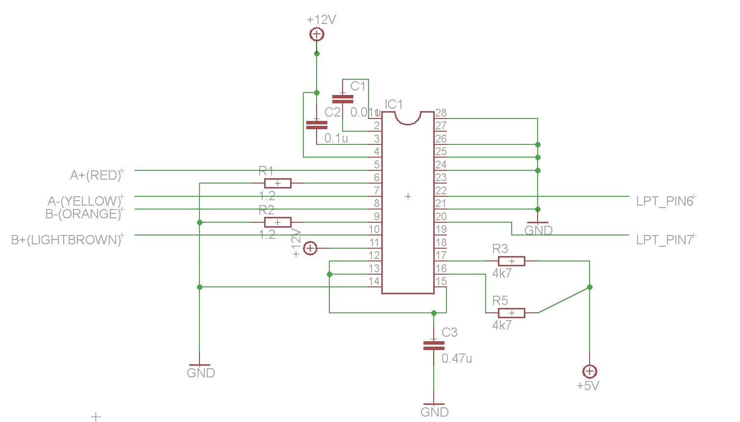

I have a problem with my stepper motor direction becouse motor always spins in the same direction when dir is high or low. drv8824 is connected directly on computer thru LPT pin6(step) and pin7(dir) i check it and dir output is low(0.12V) high(4.95V).  VMA and VMB are 12V VCP is 22V V3P3OUT is 3.3V motor outputs are connected to the steper motor with 4 wires (red yellow orange and light brown). otherwise motor works well but it spins in the same way. Please help me :)

  •  actualy have only one board at the moment becouse it is a test board and dir pin is correctly soldered becouse i check it directly from the top of the pin and it is changing signal.I also mesure out pins from Aout1 and Bout1 with oscilloscope and signal from Bout1 is allways ahead Aout1 no matter if dir is at 5V or 0V.
    Maybe there is a problem becouse sense resistors are not the same value Ra is 3.3ohm and Rb is 2,5ohm but i tryed and switch them but motor is still spinning in the same direction as before.

  • Hi Matic,
    The different SENSE resistors should not cause the stepper to move in the same direction regardless of the DIR input. It will definitely cause some major torque ripple due to different sine wave shape magnitudes. But if you see the phase relationship unchanging, then clearly the motor is doing what it is told.
    If the DIR pin is receiving the signal, then there must be something wrong with the device. Keep us posted on what you see with the second device.
