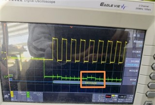

hi team,
my customer is using DRV8305 and the SCK and SDO signal is tested as below. the signal of SDI is always 0 and the VREG is 5v.
Could u kindly help to check what is the problem? thanks!
Hi Zoey,
Is it possible to get a waveform off all the SPI signals? SDO, SDI, SCLK, and nSCS?
Can they also provide a schematic?
Yara
Hi Zoey,
From the SDI waveform it doesnt even looks like they are communicating with the device, are they sure their MCU is sending anything on SDI?
Yara
