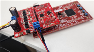

I am using BoostXL-DRV3245AQ1 EVM board.
I have set up following the document named "BOOSTXL-DRV3245AQ1EVMUser'sGuide.pdf" released at Oct 2017.

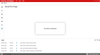

However, BoostXL-DRV3245AQ1 GUI SW can not recognize the serial port, even the Device Manger in my Windows detected COM port.
"No device selected" shows on the Serial port page.
Also, the log in the BoosXL-DRV3245AQ1 SW shows the serial ports connected as follows.
"oneui: server: hwcomm: Device connect
oneui: server: Board selected: drv3245evm
oneui: server: hwcomm: Using board - DRV3245 EVM"

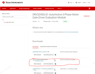

One thing I want to ask that the latest supporting version of CCSTUDIO for BoostXL-DRV3245AQ1 EVM.
I have tried with 20.0.0(02 DEC 2024), the latest version but not supported EVM.
Now, I use version 7.4.0.00015(12 DEC 2017) and 8.3.1.00004(02 May 2019) and seems working even the EVM GUI has same problem as above.
