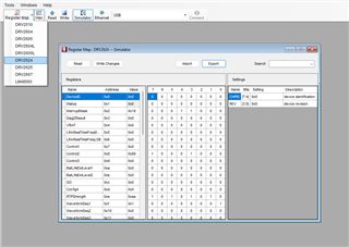

1. Is it possible to dump the Reg setup from the GUI? So we can leverage the same setting on our board directly.

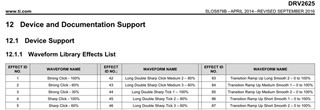

Also, DRV2625 already provide default waveform setup, wondering whether there's any way we can leverage it from DRV2625 to add into DRV2624.

    1. Yes, in the GUI you can export the register configuration. Register map -> DRV2624 -> Export.

    3. The waveforms in DRV2625 are not transferrable to DRV2624. These were developed by Immersion and these waveforms are actually the difference between these two devices. If the customer likes the operation of the waveforms in DRV2625, I recommend using that device.
