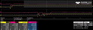

I got 2 different custom board which I made, and I got brake problem for one of them.
Let say PCB A and PCB B, PCB A is working all good but PCB B is not working with brake function.
PCB A and PCB B have exact same components, voltages and everything. When I sended 4V for brake pins, PCB A is stop immediently but PCB B is stoping slowly but sometimes PCB B is also stoping immediently.
Idk what to do about that any advice? Soldering, cabling and everything is same and okay.

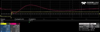

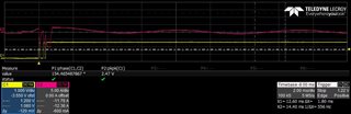

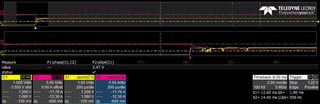

I cheched the brake pin with oscillascope and when it's not stopping immediently there is one ripple to 4.5V for 20ms then its sitting 4V, when everything is okay there is 4.1V ripple for 12ms then its sitting 4V.
I tried all this sitations with 5V also.
