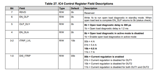

How to change the ITRIP Current limit threshold into ITRIP_LVL=00b.
Default ITRIP_LVL=10b condition

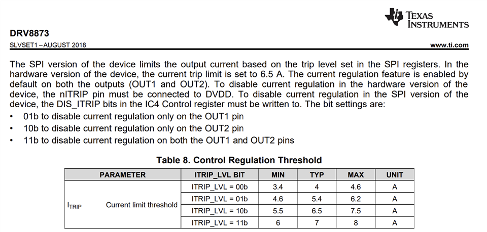

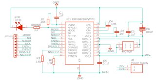

Hello Saravanan,
The DRV8873S device has four programmable Itrip levels whereas the DRV8873H has one fixed Itrip level. This cannot be changed. See below information in the datasheet. Thanks.
