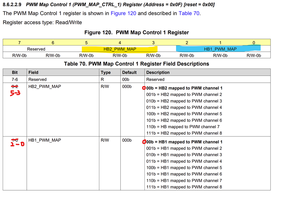

My customer met some register configuration issues when design software:
1. PWM_MAP_CTRL_1 bit numbers are not matched with description:

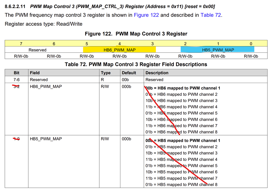

2. There are some repeat definitions for PWM_MAP_CTRL_3:

  • Hi Daniel,
    This is a known typo in the datasheet and it is slated for correction in the next revision cycle. Meanwhile, please note the following in the DRV89xx-Q1 datasheet.
    Table-70 should be as follows. Use similar fix for Table-71 as well.
    For Table-72 and Table-73 please use bit patterns similar to Table-70 and Table-71. Thank you.
