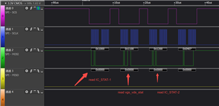

I use the development board of 8705Q,  i test PVVD =13.5v ,  DVVD= 5V ,  sleep = 5V,
2.spi sen read   : IC_STAT_1 ,  VGS_VSD_STAT , IC_STAT_2 ,but no  respond.
3.miso is alway 0.

    we just want to know why miso is always 0.  Is there any configuration fault?

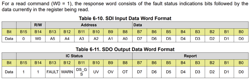

    Based on the transaction the MOSI was 0x1000 for IC_STAT_1, 0x1100 for VGS_VSD_STAT, 0x1200 for IC_STAT_2.  See datasheet page-37, snippet as below.
    Following this format, MOSI must be 0x4000 for reading the IC_STAT_1, 0x4100 for reading the VGS_VDS_STAT and 0x4200 for reading the IC_STAT_2 registers. Please try these MOSI values.
    Also be sure to remove the 0 Ω jumpers close to the header to ensure the on-board MCU does not load these pins.
