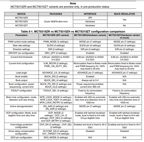

    Also just saw that there is a 8315 chip that HW variant MCT8315ZT comes without internal Buck which solves my issue. So I can use this version and dont wory about buck fucntion but still have all the other features except 4 amp peak vs 8 amp peak which is well within my peak current requirements 24 volts and 1 Amp max. However there is note as you can see in snip form spec that states:
    " MCT8315ZR and MCT8315ZT variants are preview only, in pre-production status"
    Does this mean the MCT8315ZT is not a production level part currently?

  • Hi TG,
    For the second question hardware variant buck cannot be disabled.
    I don't have RTM date clarity now, I will notify you.
    Can you provide details about end equipment ?
    I am sending message to you; I will notify when I get RTM details.
