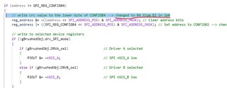

  • Hi Ibinu,
    Please see below:
    For example when i want to use 20 kHz:
    0xA623, 0x0000, 0xDFDF, 0x0000, 0x0000,
    i use the example on the ti website as a code base, so i integrated crc (and every change with 2p0) and applied it to my code.
    The SPI-Output is:  So it looks like "Default"-Values with 10 kHz. ConfigA looks good (3.5 A / 1A Hold and 56ms Peak)
    Changing just B4 for example to C000 works (i think)
    0xA623, 0x0000, 0xDFDF, 0x0000, 0xC000,

  • Hi Daria,
    Just to clarify the PWM frequency register is Config B2.
    The CRC register was moved from Config B2 to Config B4 for the latest revision of Silicon.
    SO if we write the Config B2 register for PWM frequency that should setup the device with the correct setting. Please let me know if this clarifies.
