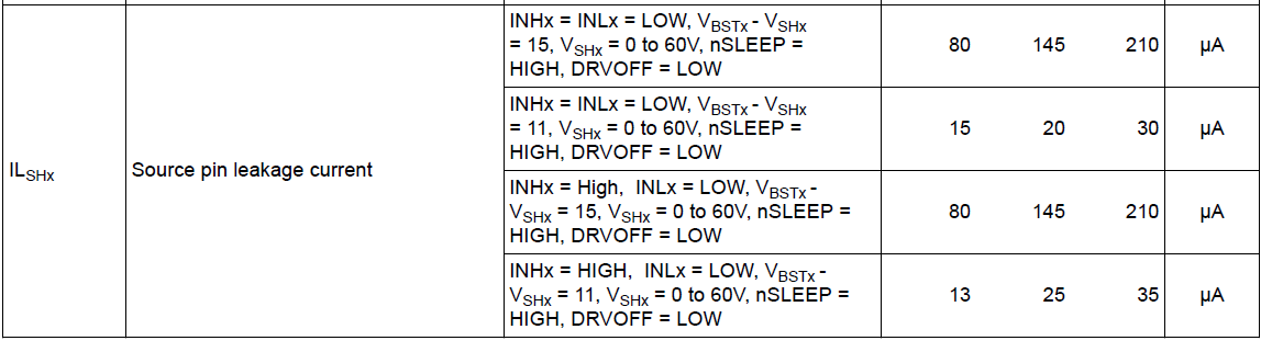

1. Must the pin Pdd be connected with the top supply of power-MOSFETs (ICs: DRV8328 +8329)?
2. Can the pin Pdd be supplied from a buck with an output voltage of about 5V?
3. Where can I find the source pin leakage current for other families DRV 835x + DRV8323 etc?
