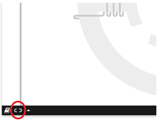

Hello Fujimura-san,
Please try File -> Program DRV8214, which would install some drivers. Then, please click on the following button to connect hardware (bottom left corner of your GUI window):
Let us know if this does now work.
Karan

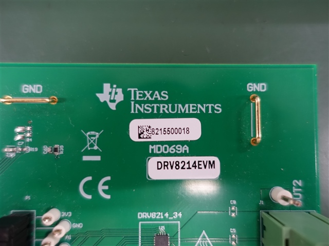

Hello Karan-san,
I have 2 EVM boards. Both of them were failed to connect.
purchase date are 2023/10 and 2024/6.
I show the picture of the EVM board which I got in 2023/10.
Best regards.
Thanks Fujimura-san,
Could you please send a picture of the Resistors R39, R52, and R41? They are the ID resistors and I want to make sure they are populated correctly. If you can see values too, for a sanity check, that would be great!
Additionally, I do see that the marking in your image is MD069'A' whereas the latest one we released is MD069'C. Please give me a day to look into this. If you could provide the ID resistor picture in the meantime I'd appreciate it.
Karan
Hello Karan-san,
Please see attached picture. R39,R52 and R41 are populated. They are 10kohm.
1pin and 2pin are connected with jumper at J6.
Norio Fujimura

Hi Fujimura-san,
I have looped in our experts to help here since I've exhausted all my options.
Meanwhile, I will request Goto-san to get two fresh EVMs to you that work.
Karan

Helllo David-san,
I got the new EVMs from Goto-san. The new EVMs are connected to the PC and works fine.
New EVMs version is MD069'C.
MD069'A and MD069'B are not connected to PC.
MD069'C is connected to the PC.
What's the difference MD069'C and the others?
Norio Fujimura
Hi Fujimura-san,
I'm glad the MD069C EVMs worked. The changes made from version A to C were minor hardware changes but shouldn't have caused any connection issues. It's possible the latest version of FW wasn't flashed onto the older versions.
