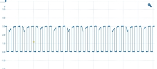

Hello.
I am trying to control a nail drill using a combination of MCF8316AEVM and ATmega328PB Xplained Mini.
In order to use it at a maximum of 30,000 rpm as a product, I have set the MAX_SPEED of the MCF8316A to 36,000 rpm and am controlling the rotation speed via I2C.
In this case, when the speed is set below 5,000 rpm, the rotation becomes unstable and stops.
Below are the current register settings.
Please let me know how to improve this.
This is my first time working with a motor driver, and I'm unclear about many of the meanings of the register settings, so I'm setting them up blindly.
I'd appreciate any advice you can give me overall.

  • Thank you for your reply,
    I have already performed testing using the GUI.
    When testing with the GUI, it did not work at all at first, but after rewriting the MSP430FR2355 firmware, it finally started working. After that, some kind of problem with the PC caused the GUI to not start up, and since it did not recover, I am continuing the evaluation by switching to external CPU control.
    With external CPU control, MPET is also performed at startup, and I believe that motor-specific parameters are obtained.
    I am monitoring the ALGORITHM_STATE Register, and at startup, it transitions from ALIGN to OPEN_LOOP to CLOSED_LOOP_ALIGNED.
    I am also monitoring the CONTROLLER_FAULT_STATUS Register, and when the motor stops, MTR_LCK=1 and ABN_BEMF=1 occur.
    Given the above situation, could you please give me some appropriate advice?

  • Hi Inashima-san,
    Wha is the type of load?
    In your JSON I see accel and deccel is set for large value 1000Hz/s, I am not sure if your load inertia works.
    Reduce to below 50Hz , keep same KP, KI and test.
    Can you increase speed kp/ki gain (double both) and torque ILIMIT?
    Also current loop KP, KI was too low, I made it 0 so that device auto calculates the value.
    What is the device number autodetected by motor studio?
    Even though the legend marking is MCF8316A EVM the device will be replaced with MCF8316C.
    In this device due to bandwidth I2C communication is restricted while running the motor, this is not convenient for motor tuning cycle.
    Please verify MCF8316A errata (+) [FAQ] Production device information - Motor drivers forum - Motor drivers - TI E2E support forums
    Can you measure R , L all phase to phase and share.
    Please refer to the tuning guide MCF8316A Tuning Guide (Rev. A)
    Using oscilloscope voltage probe, hand spin the rotor and capture peak to peak voltage and one cycle period value. With use formulae shown above.
    Thanks and Best Regards
    Venkatadri S
  • Hello, Venkatadri-san.
    The motor is for a nail drill. The load is very light.
    On another PC's GUI, the following values ​​were detected for R and L using MPET with default.json:
    R=1.25Ω
    L=0.06mH
    In inashima.json, the following values ​​were detected by MPET in the GUI, causing an error stop:
    R=1.40Ω
    L=1000mH
    These values ​​are nonsense, aren't they?
    The device detected is MCF8316A.
    I'll let you know the current situation so far.

    2. When the rotation starts, for example, if you set it to 3000 rpm, it will first slowly increase from 0 rpm to 8000 rpm, then suddenly drop to 3000 rpm and stabilize at 3000 rpm. This takes about 10 seconds. At this time, there is a high probability that the motor will stop. When it stops, an "abnormal BEMF motor lock state" occurs.
    → How can I stabilize the operation so that it does not stop?
    → How can I transition to the desired rotation speed quickly when it starts rotating?
    3. When observing the FG signal with an oscilloscope, ripples like the one in the photo are generated.
    → Does this help solve 1 and 2 above?
    I will send you the modified json file. any advice would be appreciated.
