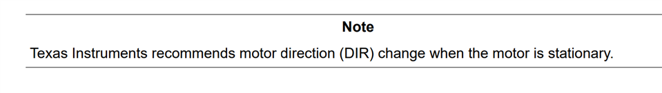

It seems : it is needed to turn nSLEEP input to LOW to register a direction change on input DIR.
If I just change DIR alone, the direction of rotation keeps the same.
If I turn nSLEEP from HIGH to LOW, then toggle DIR, then nSLEEP back to HIGH, then the direction change.
Can you confirm ?
