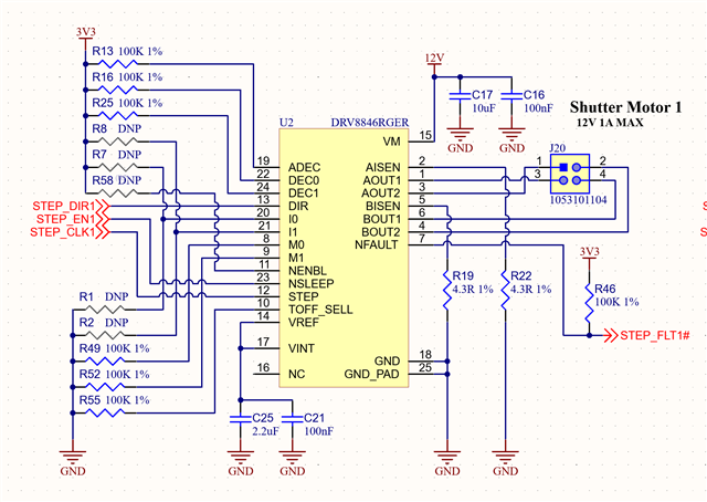

In our application we are trying to use the DRV8846RGER Motor driver, however when we power the device on, we leave nENBL floating(Internal pull-down) and drive nSLEEP high from our controller, however VINT stays at 0V, and since we are driving VREF with VINT, VREF is also 0V, we have tried driving VREF separately from a 3.3V supply, however we still do not observe anything on the output of the motor driver.
Below is our circuit for the driver
This is our first spin of this design using this part, so we do not have a history of this working before, our motor current is limited to <125 mA

    Based on the schematic VREF = VINT = 3.3 V TYP. , Rsense = 4.3 Ω, Torque DAC is 50 % both I0 and I1 floating / Hi-Z. This puts the IFS at 58 mA. You mentioned motor current is limited to < 125 mA. Assuming you'd want it closer to 125 mA you may have to set Torque DAC to 100 %. I0 = I1 = GND.

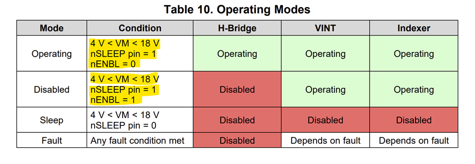

    VINT must be 3.3 V in order for the internal blocks of the device to function. VINT = 0 V points to issues. VINT must be 3.3 V under the two highlighted conditions in the below table.
    VINT is disabled with an under voltage condition UVLO. The nFAULT pin is driven low during an undervoltage condition and is released after operation has resumed.  Based on the schematic VM = 12 V, I do not anticipate an UVLO. Could you please verify nFAULT is not driven low?

    I do not see anything unusual in your schematic. Could you please check for a potential short to GND on the VINT / VREF trace? Thank you.
