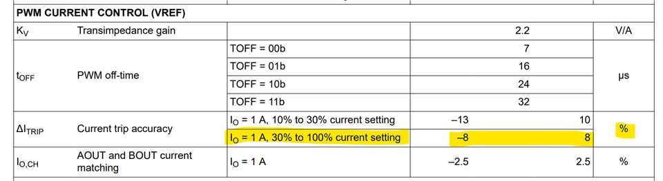

    Would this be while stepper motor is stopped or while the motor is stepped and spinning? In full-step mode both A and B current would be 100% (+/-) depending on the step position. The device to device variation could be within the current regulation accuracy specification - see highlighted data in the below table from the datasheet.

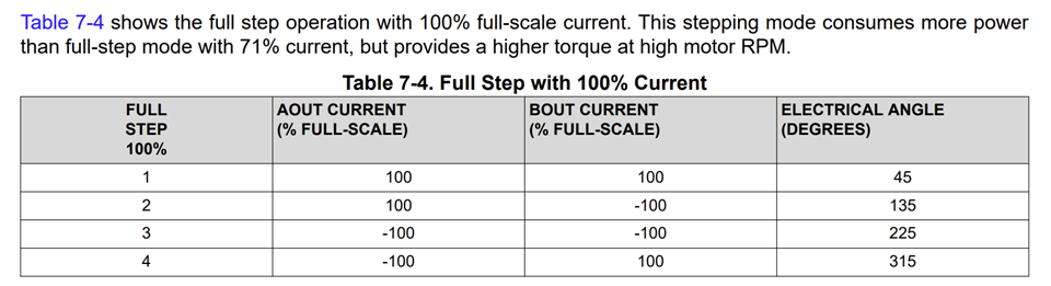

    See below table. Based on this, the current draw on VM will be 2x the IFS at all times with the stepper motor connected to the driver.

    1) (VM - VBEMF) > IFS x DCR of the motor. What is the VM voltage and the stepper motor specifications R and L values?
    2) When the motor is still (STEP pin = 0) you can measure 100 % IFS coil currents for coil A and coil B.
    3) When the motor is spinning, the current waveform for coil A and coil B would represent a square wave with + / - 100 % IFS amplitude. Please share the current waveforms of coil A and coil B for analysis.
