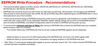

  • Hi Aman,
    Please refer to the FAQ link (+) [FAQ] MCF8316C-Q1: General EEPROM Write procedure recommendations - MCx83xx family (MCF8316A, MCF8316C-Q1, MCF8315A, MCF8315C(-Q1), MCF8329A, MCT8316A(-Q1), MCT8315A, MCT8329A) - Motor drivers - INTERNAL forum - Motor drivers - INTERNAL - TI E2E support forums
    We highlight device conditions in order to program EEPROM successfully.
    Jus a quick note, EEPROM write/read should not be done while device is in Motor Run state, we should put device to Motor Idle state.
    Then proceed for write instruction and before power cycling or issuing motor run command make sure to provide minimum delay of 500ms, verify EERPOM write bit is cleared which indicates successful completion and then power cycle.

    Please understand that there was no issue in flashing the EEPROM. The motor driver was working as expected. The issue only came after a long time and no deliberate flashing attempt was made after the first flash. Hence I wanted to know if there is any other condition (line undervoltage, brown-out etc) where EEPROM data can get corrupted, leading to the data getting reset.
    The datasheet mentions a minimum delay of 300ms after sending EEPROM write command, so please let me know the reason for that extra 200ms (regardless, I am sure that the EEPROM was flashed properly). However I couldn't find any mention about the connection between EEPROM_WRT bit and EEPROM write status in the datasheet. Please mention the section, incase I am missing it.

    I am copying the image here which answers your question about minimum delay
    About the issue, can you confirm in your application are there anywhere EEPROM write function exists and when it is invoked?
    This is a common issue, may applications call EEPROM write during every power up and verifies if the configuration is not matching.
    Reasons
    1. Let us say when EEPROM write started and there is power drop which leave in complete EEPROM writes.
    2. Power cycling after EEPROM write instruction without waiting for minimum delay.

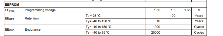

    The EEPROM endurance and programming voltage are good.
    Only if any issue with the sequence like mentioned before EEPROM can be changed.

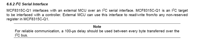

    Wanted some clarification on the below note given in datasheet
    Currently this is being violated, as this is not feasible to insert 100us delay after every byte as this will severely hamper the communication rate and hence the overall functionality. Can you please comment on this.
  • Hi Aman,
    We do not need this, device implements clock stretching.
    When motor is running there can be bandwidth issue, hence we recommend 100uS delay or us lower I2C clock frequency.
