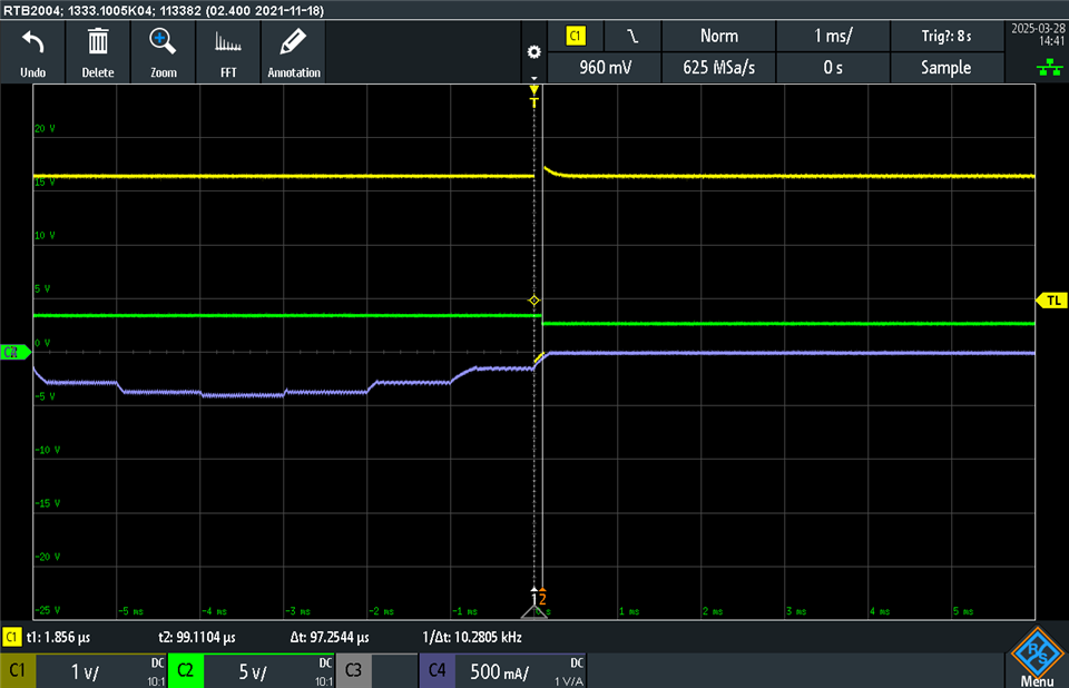

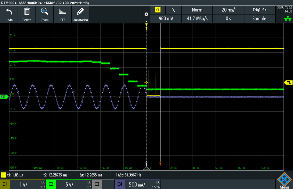

  • Mojtaba,
    What is the reason for this delay.
    We are also noticing a glitch on the fault line, when a clear fault is sent out.
    It seems like, in in fault, the DRV decides to lower the line back after a clear stall command. Is this intended? It only seems to happen when a clear stall command is sent down and the system is in stall. All other spi commands show no glitches when the fault line is low.
    Here is an expanded version, showing the glitches when the clear stall is sent down. The time between the fault line going low, then high is ~12ms.

    There are no step pulses issues when we try to clear the fault. In fact, the host software stops issuing steps, the moment it detects a fault and then issues a clear fault.
    A rising edge in STEP causes a step. Are you saying that leaving the the STEP high could be an issue?
  • Here is a sreenshot showing the step signal, going low.
    The FLT line still goes high every time the clear fault spi command is sent.

  • Hi Gerry,
    What is the D2 FLT trace? I assume the A2 FLT is the nFAULT pin. For every CLR_FLT command, the nFAULT is cleared with the high going pulse but immediately a fault is again detected. As soon as a stall is detected can you set the stall threshold register to 0 before issuing a CLR_FLT and see what happens? Thanks.
    Regards, Murugavel

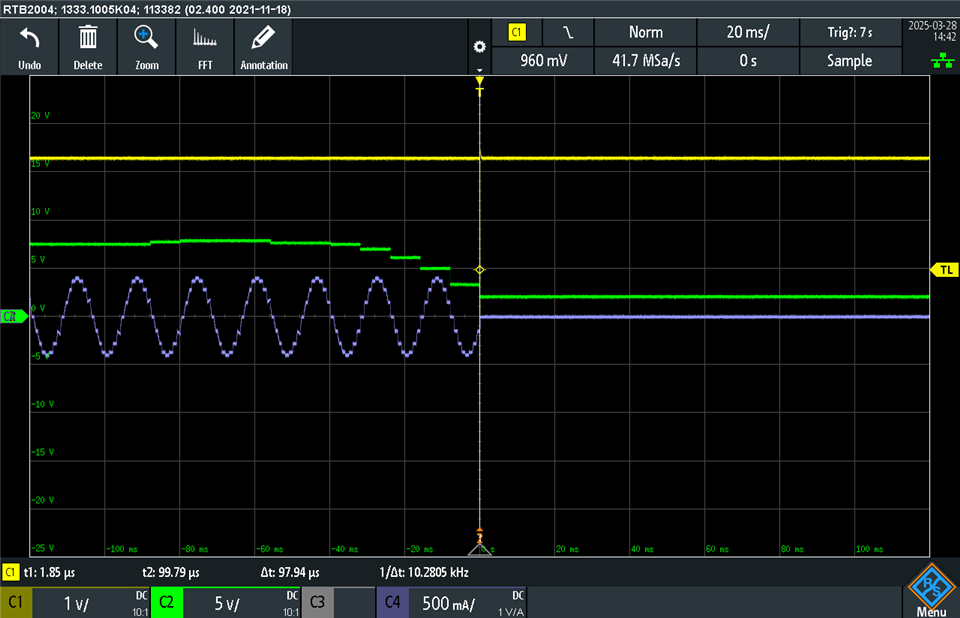

  • D2 FLT is what the Salea sees as the logic level of the fault line vs. A2 which is the analog version of the same signal. I turned A2 on because the chip was reporting tons of fault interrupts, after a few hours of debugging on the code side wanted to see the voltage level directly and that's what caught the odd spikes in the fault line around clearing.
    Here is a capture where:
    - CTRL6 is written to 0x0 to set the stall threshold to 0x0 immediately before a stall clear (write to CTRL4 with high bit set) is issued.
    - Stall threshold is being restored before we begin stepping again.
    The markers in the image show (from left to right):
    2 - read of fault register 0x0
    3 - read of rev id (we do a lot of rev id reads to ensure we've got stable comms)
    0 - write of 0x0 to CTRL6 to set stall threshold to 0
    1 - write to CTRL4 with high bit masked into the present register value to clear the fault (do we need to read-modify-write this register? we didn't want to alter its previous value when clearing the fault value but it does result in an extra read)
    4 - write of 12 to CTRL6 to restore the stall threshold to 12 before we begin stepping again
    It appears that the fault line glitches are not present in this trace. The fault line also rises immediately after the clear is sent, without any fault clear retries being necessary.
  • The second fault is unexpected and causing an issue with our system. We've changed direction and are trying to step to find the other limit of the system, we shouldn't get a fault for several seconds. The second fault appears to be occurring immediately upon restoring the threshold to 12. See how it aligns with marker 4 in the image here.
    At that point stepping has not started again.

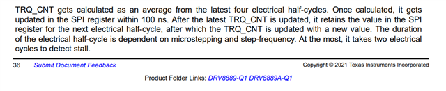

  • Hi Chris,
    Thanks for doing the tests and sharing the results. This is helpful to narrow down the issue.
    The torque count may lower than the threshold at that point because the stepping was not started yet. It takes two electrical cycles (one electrical cycle = one full waveform - sine wave in the case of mircrostepping) for torque count to be updated to the new value and once stable the latest value is updated every electrical half-cycle.
    Setting the threshold after step pulses are input will help avoid this second fault. Thank you.
    Regards, Murugavel

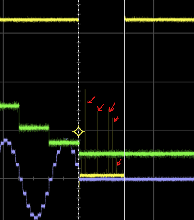

  • How long was your delay before the fault clearing was attempted? It was a bit tricky to catch the fault glitches as they are very narrow.
    In our case if the clear occurs < ~250ms it doesn't stick.
    In the above traces we attempt to clear some 200uS or so and we see glitches on the fault line after each of these clear attempts until the total elapsed time is ~250ms from the fault occurring.

  • Hi Chris,
    Thank you for your patience.
    I was able to speed up the EVM firmware scheduler as well as modify the code to perform a CLR_FLT as soon as the nFAULT pin was read LOW. Still was not able to use interrupt but could read it much faster than the regular EVM firmware. As soon as the nFAULT pin was detected LOW I did a stop issuing STEP pulses and then did a CLR_FLT in CTRL4 register. I could reproduce the issue that you observed. At this time I do not have an explanation for the behavior. We're looking at the digital logic design to understand the behavior.
    Meanwhile I tried a work around which seems to address the issue. The sequence as follows. After nFAULT pin was detected LOW stop issuing STEP pulses and STEP input LOW. The disable stall by writing EN_STL = 0 in the CTRL5 register. Do a CLR_FLT in CTRL4. Next enable stall by EN_STL = 1. This enables stall detection for the next cycle. This seem to work consistently. See below captures. Yellow trace is nFAULT, green trace is torque count analog voltage converted from CTRL7 register reading and a DAC, and blue trace is the coil B current. You can see the torque count reduce as the motor approaches the end point and eventually stalls. nFAULT turns LOW and then cleared by the CLR_FLT. Took about 100 μs with the modified scheduler. Running multiple cycles yielded consistent results with the CLR_FLT.
    For context see below capture which does not do EN_STL = 0 prior to doing a CLR_FLT. There are intermediate spikes as the loop attempts several CLR_FLT attempts every scheduler cycle. To be specific I was never able to reproduce 250 ms of delay instead the delay was consistent around 12 ms with my EVM HW.
    Let me know if any questions. I hope this will help you to move forward with the work around. I will close with you as soon as we find the reason for the unexpected behavior of the CLR_FLT while EN_STL = 1. Thanks.
