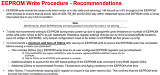

    1. Are you trying to issue eeprom write instruction? We have some recommendation to follow the process to avoid incomplete EEPROM writes.
    2. Speed pin has to be high even if I2C is used for speed command., Speed pin is used as WAKE/IDLE when I2C based command is configured.
    Please follow below mentioned procedure for EEPROM programming
