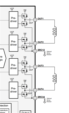

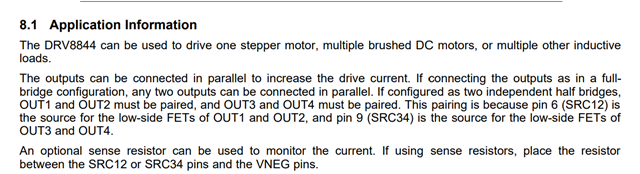

    Is that also true for the DRV8844?
  • Hi Michael,
    It is different for the DRV8844 because two source pins of the FETs are internally connected. Below info from its datasheet.
    Regards, Murugavel
