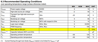

The datasheet specifies that DRV8351 is meant to drive NMOS (N-channel power MOSFETs). NMOS slew VDS voltages much slower than GaN-targeted applications. Too high of an SHx slew rate can result in electrical overstress.

The significantly faster switching speed is definitely a big selling point for GaN HEMTs so I think if you're not able to take advantage of that then it'd be good to stick with NMOS.
DRV8351SEP specifies the maximum SHx slew rate is 2V/ns (This is best case scenario with optimal layout design, I would actually stay around 0.5V/ns - 1V/ns to really avoid any issues with SHx)
