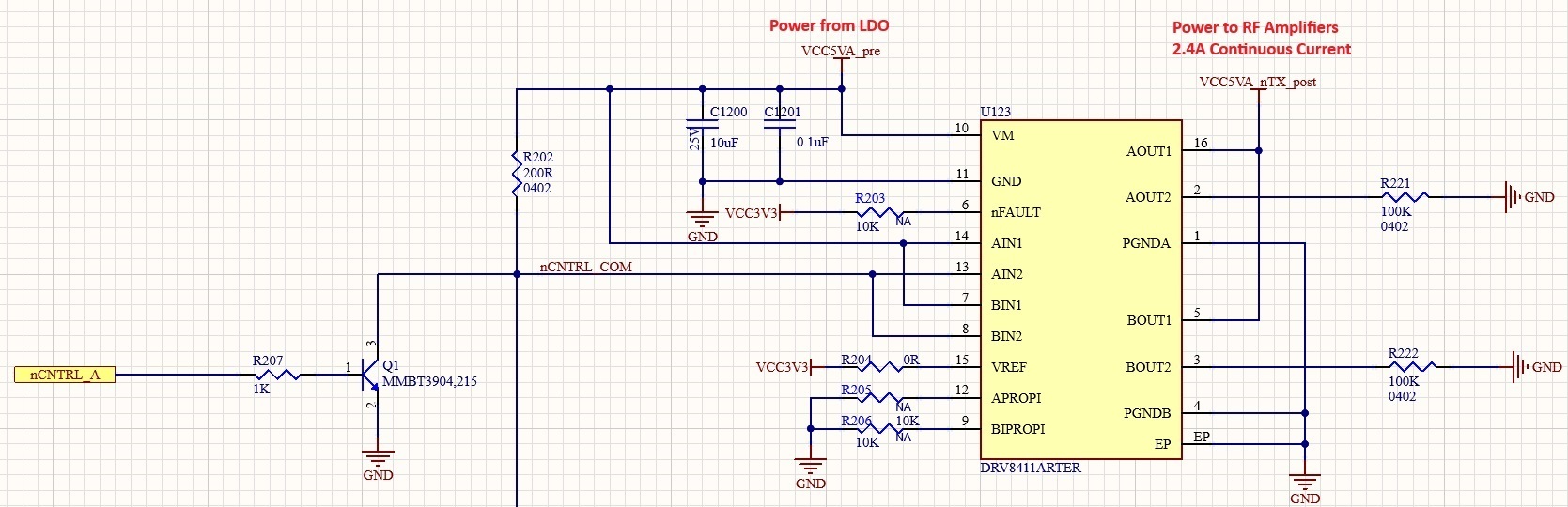

  • Hi Mojtaba !
    How are you?
    This is the setup I'm using:
    Is this correct in order to transfer 2.4A continuously?
    Is it necessary to add resistors to prevent shoot through situation?
    Yonatan.
  • Hi Yonan,
    Thank you for updating information. The schematic looks fine.
    Please refer to Thermal Considerations section 9.1.1.3 for detail explanation.
     https://www.ti.com/lit/ds/symlink/drv8411a.pdf?ts=1740597120835&ref_url=https%253A%252F%252Fwww.ti.com%252Fproduct%252FDRV8411A
    The Maximum Output Current of a motor driver is a function of die temperature. This, in turn, is greatly affected by ambient temperature and PCB design. Basically, the maximum motor current will be the amount of current that results in a power dissipation level that, along with the thermal resistance of the package and PCB, keeps the die at a low enough temperature to stay out of thermal shutdown.
    Total power dissipation for the device is composed of two main components. The power MOSFET switching losses, and the power MOSFET RDS(ON) (conduction) losses.
    PTOT = PSW + PD
    PSW = PSW_RISE + PSW_FALL///   PSW_RISE = 0.5 × VM × IRMS × tSR × fPWM ///   PSW_FALL = 0.5 × VM × IRMS × tSR × fPWM
    PD = (IRMS) 2 × (RDS(on)High-side + RDS(on)Low-side)
    The device had an effective thermal resistance RθJA of 45°C/W. The junction temperature TJ value becomes:
    TJ = TA + (PTOT × RθJA)
    The actual system performance may be better or worse than this value depending on PCB stackup, routing, number of vias, and copper area around the thermal pad.

  • Hi, thanks!
    I'm not working with PWM so I don't have switching losses. Correct?
    P.S... in the schematic above i use the component as a power switch which connects and disconnects the main power (VM pin) to the Load (AOUT1, BOUT1 Pins)
    according to its control pins (AIN1, BIN1, AIN2, BIN2)
    Yonatan.
  • Hi Yonatan,
    Thank you for your questions.
    If it is on/off switches, you can ignore the switching loss.
