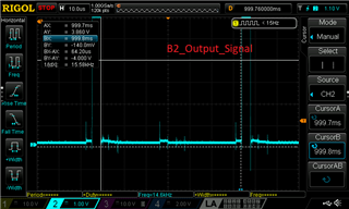

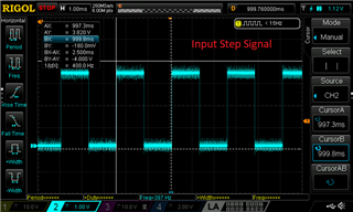

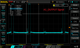

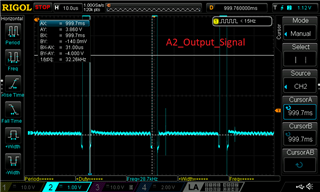

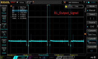

    Thank you for your response. After changing the MOSFET, OCP not occurring.
    We have configured the driver with the register initialization parameters as you mentioned. However, the output is still not being driven properly through the output channels (A1, A2, B1, and B2).
    We are providing a step pulse at 400 Hz with a 50% duty cycle, but the output is not changing as expected based on the input step pulse. Output is stable even if we change the pulse switching. Please find the attached image of the input and output signals for your reference. Kindly guide us to resolve this issue.
    Arun
  • Hi Arun,
    I can not see anything wrong with output voltages, T_off is around 30us what is good and according to settings. I guess you use DRV8711 in indexer mode ie.
    PWMMODE is set to 0. In this mode DRV8711 sets automatically PWM duty cycle to get desired motor phase current and PWM duty cycle depends on VM voltage, motor parameters, motor speed and its BEMF voltage. If you set microstep MODE to 1/16 or more motor phase current should ideally get sinusoidal shape like on Figure 16 in DRV8711 datasheet. The easiest way to measure phase motor current is with current probe. Does your motor spin?
    Grzegorz
  • Hi Arun,
    Please let us know if your issue is resolved. Like Grzegorz mentioned please try to use a current probe to get the current waveform for coil A or B. Be sure the DRV8711 is set to indexer mode - default setting of OFF register, PWMMODE = 0.
